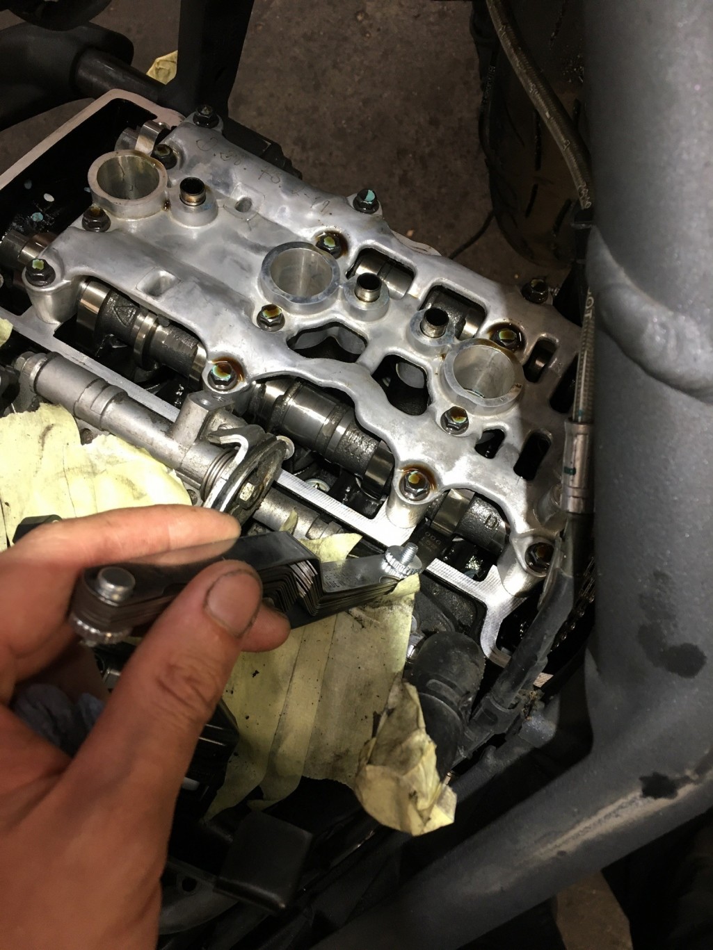

Hey all, I carried out a full 24k service this past weekend and thought some may be interested in my valve clearance measurements.
They were last checked around 15k and have never been adjusted, this time round is exactly the same and the measurements barely moved.
Any the difference measurements between now and then could be down to a few factors; difference in my feel compared to Clive Wood or difference between measuring tools. I used 2 sets of extremely high quality Bluepoint / Snap On feeler gauges which have incredibly fine increments compared to your typical set, IIRC Clive used Wurth feeler gauges.
All the valves are comfortably within the middle range of the specifications so I feel comfortable with skipping the next 12k check, Iíll just carry out the full engine & chassis service.

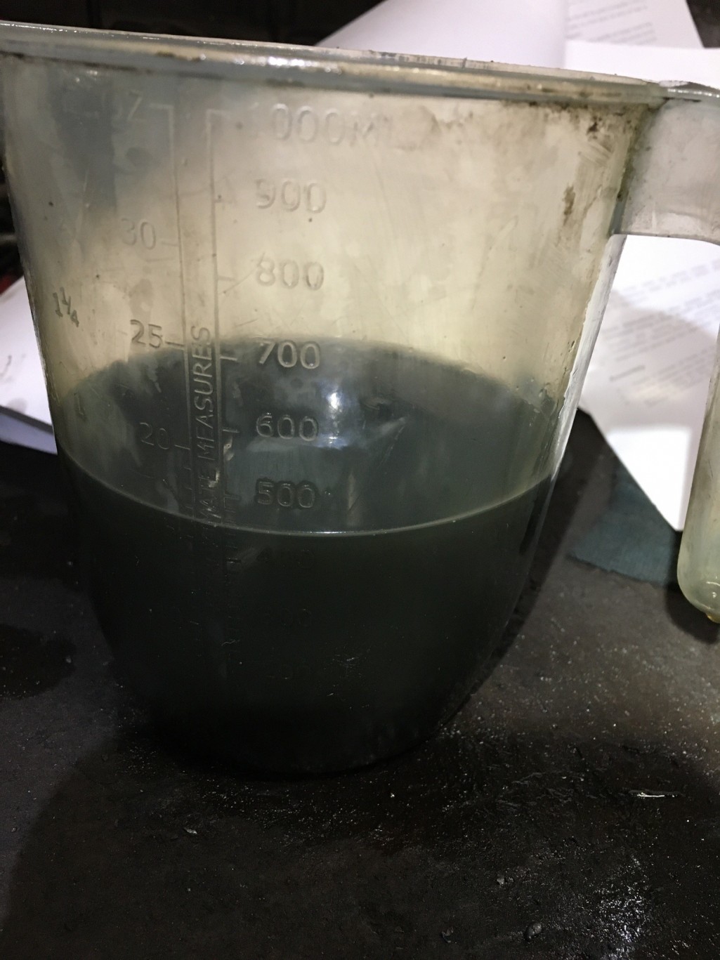

I also changed the fork oil, the oil itself wasnít bad, the first 200ml looked like new oil! As I got to the bottom of the fork oil, quite a lot of wear metals were present and made the oil black. I flushed each fork with around 1.2 litres of new oil and it runs clear with little to no wear metals left. The forks have never been serviced and are still running original seals, never leaked, no signs of deterioration at all so I chose not to change them.
My oil of choice was Motul Factory Line Very Light 2.5 Wt. Iíve looked up several fork oil comparison charts and itís the closest match in viscosity to the factoryís Kayaba (KYB) KHL 15-10. The Motul is also fully synthetic so I hope it slows down and prevents any further wear.
The manual recommends a fork oil change every 24k which I knew was way too long but I only recently decided to buy a fork spring compressor to carry out the job. Any suspension professional / tuner knows the oil is past its best by about 7,000 or 10,000 miles. From now on Iím changing it every 12,000 or 3 years.

UPDATE
Valve clearance specifications
Inlet: 0.10-0.20
Exhaust: 0.325-0.375
Current valve clearance
Valve clearance at 15,471
Sorry for the image orientation, Iím not sure how to fix it on the image hosting site :027:
