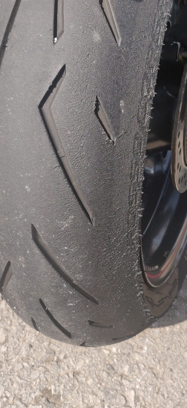

Tyre pressures are a tricky one. All depends on the Tyre the temp of track and ability. start with pressures as stated. When you get in check the temp of tyres if nice and hot with even wear your are there. (should feel just hot enough that you can leave your hand on them but any more would burn you) if cool and have a rough shredded look you may be too high. If crazy hot and hard to turn may be too low. 30/30 or 30/27 (what i ran on corsa 2's) should be fine. If you speak to the Tyre support guy he can advise what is likely to work for you on the day. If the Tyres move a bit out of a corner drop a psi or two till you are happy.
